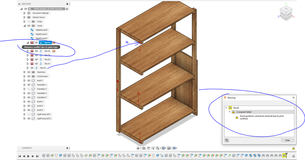

Hi, Am new to Fusion 360, DIY hobbyist, first post on the forum. Am trying to create a book shelf, that can also act like a stepped shelf. I am able to add multiple revolute joins between the frame bars and shelves, but at a certain point, when I add  another join it warns about conflicts and the previously successfully added revolute joints also show a "distance conflict due to join type" .
What might be the  issue? Have attached screenshots before and after adding the last revolute joint, as also a screen cast, and the exported archive file.

Nothing is grounded, and too many capture positions, but
When revolve joints misbehave, you find the misalignment.
Your top front revolve will not work as currently set up, because the hole spacing in the shelf, (14 in)
does not match the hole spacing in the rigid frame (13.994 in), and must be 14 inch in Fusion.

@saranga2000 Delete all the capture positions and never use them again or I kill you(joke), then do an as-built joint between frameBar 1 and the world origin, then on each shelf do a joint from the shelf to the frame bar 1 then an as-built joint between each shelf and framebar 3.
In a way, you had it backwards you lock one thing down so it does not move the very first component do an asbuilt joint to the word origin so this part is locked in places that would be frame bar 1.
You have to plan it out so you have something locked in places then everything is built from that so for you it is asbuilt joint to the world origin then joint the shelves to framebar1 then asbuilt joint from the shelf to frame bar 3 the other frame bars leave them alone.

Whilst not a factor here, AS Built is not a good idea if parts are changing due to parameters.
Shortened the timeline a bit.
Message 5 of 9
saranga2000
That worked, learnt from your timeline, thanks much!
