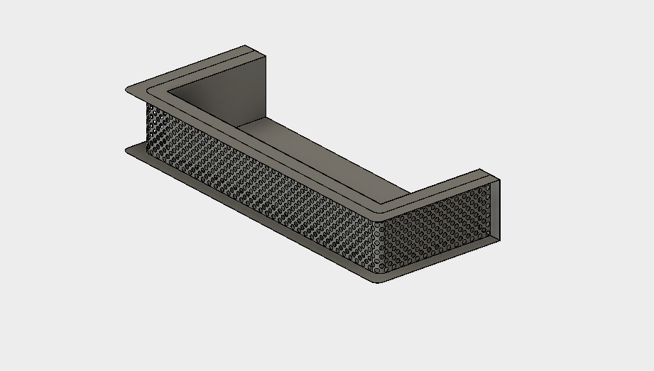

Hello 🙂
I'm trying to pattern a serie of holes along a path but i have inconsistent result when it comes to corner.
sometime exagerated deformation, sometimes no holes at all, etc ...
(see different result in images bellow)
Any idea of the cause and how to fix this !
Here is my process :
Basically i did a sketch on one of the short side with the two first (vertical) row of holes then extruded them.
Selected pattern along path --> choosed pattern feature --> selected my extrusion --> selected my path (see image bellow)
also selected "orientation = path direction"
( i think i will swich this method for a sketch in the middle of the long side so that i can have the same spacing at the extremity of the two small side - and i might also start with only two holes and pattern these verticaly before patterning again that first pattern along the path .... But i guess that's not a 100% relevant to this inconsistent result problem, or is it ?
Any help / tips is greatly appreciated 🙂
thanks in advance !!

I've played with this a bit and have a couple of pointers for you. First you need pattern the holes one column at a time the the centre of the hole will be perpendicular to the surface, using 2 columns seems to have the mid point of the 2 columns perpendicular.
The second tip is to adjust the start and end points for the path so the start is in line with the center of the column of holes and the same for the end point.
I've not got the spacing quite right but the holes now go around the corners quite well.
Mark

I've figured out you need to make sure the start point on the path needs to be on the centre line of the holes or you'll have problems.
Here's an example where the holes and the start are quite far apart.
And here's what happens at the corner.
Mark

That did the trick ... restarted the sketch from the center of the long side and applied your precious advice to a pretty much perfect result !! Screen Shot 2016-05-21 at 1.51.10 PM.png
