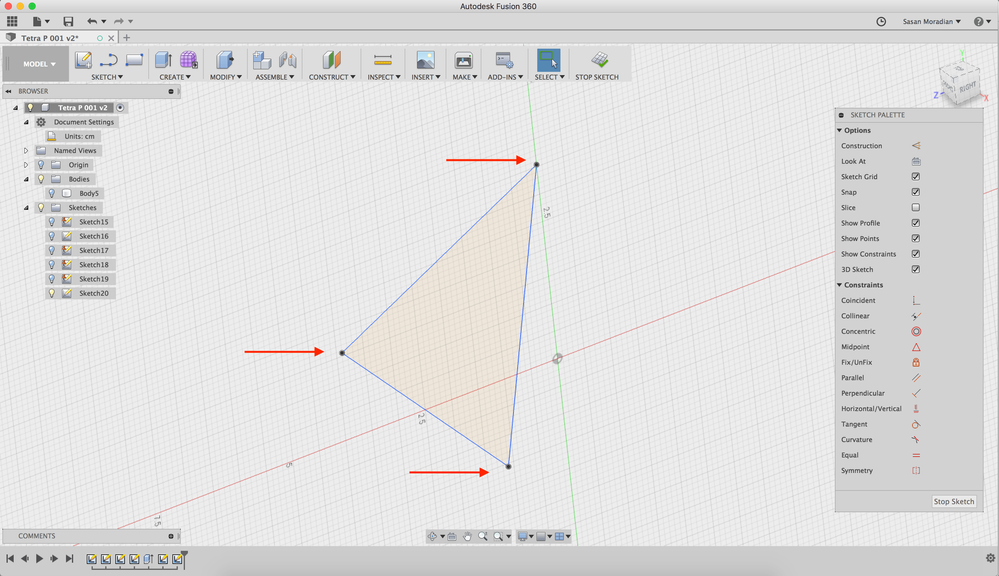

I am trying offset a sketch but for some reason, I cannot select the sketch.
Is it possible fusion cannot offset a sketch that is in perspective?
Thank you!

Are you certain that you are editing the sketch that contains these curves?  If so, the other thing I noticed was the black points at the end of your lines.  These indicate that the lines are not joined together.  How did you create these lines?

Thanks, Jeff,
I am used Line.
Would you please advise how can I join them?

Hi Jeff,
I joined the lines, but still, I cannot offset it.
Please find the attached.

davebYYPCU
Sketch 20 is a 3d sketch, offset is not available, in 3d sketches.
