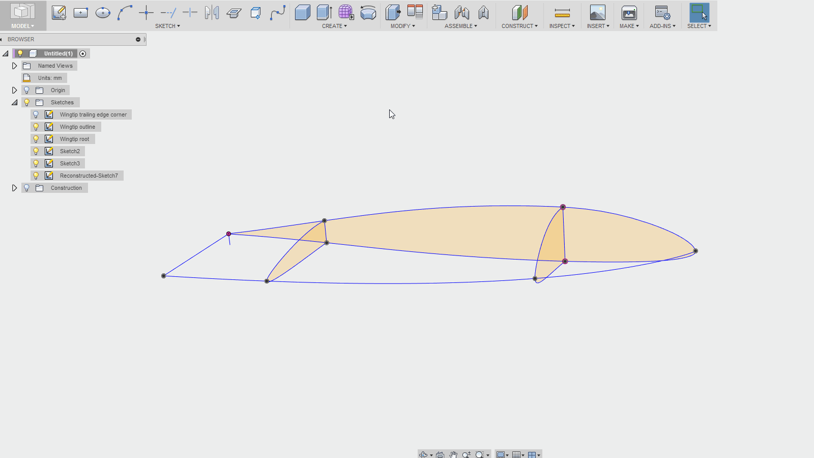

I am using the latest version of Fusion 360 to try to create a wingtip that has a fairly organic shape. I have been attempting various lofting methods with no success. As the wingtip has multiple complex curves, The profiles are at right angles, and there are two intersecting edges.  Honestly as a beginner, I'm not certain that I am even taking the correct approach at this shape, and I could really use some guidance.

@cekuhnen, that looks very close to what I am attempting to accomplish. However there are a couple of critical differences. The trailing edge should extend out and down. Accordingly the top and bottom half are not symmetrical (though I think I can see how to do the asymmetrical profile from your first example). This was a defining feature on this model of airplane, so I am keen to replicate it as closely as possible.
I've read from this thread that I can in fact loft from an edge (is that what you did here). However if you see in my file that the edge "wingtip root" can only be selected as a single piece. I see in your example that it is split into a top and bottom half. Please forgive this very beginner question... how did you split it into two edges? I suspect this is a core part of my problem. That and perhaps the existence of the trailing edge.

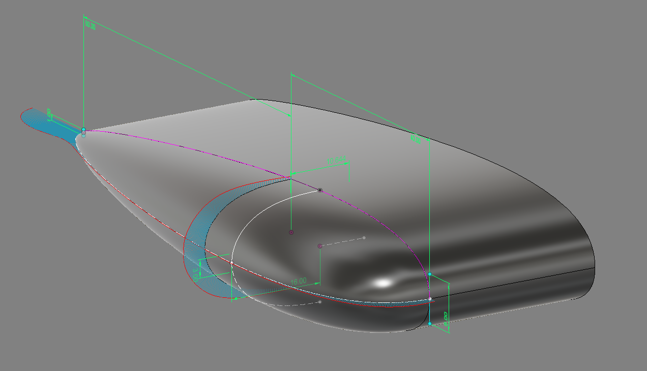

I had a look at your wing tip lofting now that I am home again, Good job really.
Couple of heads up, as my 2 cents.
the tip profile has caused a small amount of undercutting nearer the outside front, that can be filled no worries, but there is also a small amount of concaving on the bottom surface loft - generally near the back of the leading edge stock intersection, call me picky but that area would need some fill as well in my model.
To see this better I used the section analysis on YZ plane and pulled it forward to about 161mm,
May I suggest another rail profile up near the leading edge stock position,
However if you're happy, go with it.

Thanks for the pointers. I'm overwhelmed by the positive support I've seen among the Autodesk community - even for us beginners.
I see your point about the undercut at the tip. I assume this is what you are talking about? It is well within the tolerances for my purposes. But if I wanted to fix it, what would I do?
The concave at the back of the airfoil is part of the JM-3511ST airfoil. I was a little surprised by it as well when I noticed it, but I had to do quite a bit of fiddling to try to get it right. You can see the profile in the "Airfoil" canvas. Unfortunately at scale, there is a bit of blur in the canvas image making the exact profile hard to nail. But I think I'm close enough for a model airplane.

Your screenshot was not clear to me if you found what I found on the outside front of the wingtip.
(If looking from the model nose front on but towards the tip,)
I edited your model in that area, and got a respectable result, by adding two more rails right up the front, one at 155, and the other at 162mm
There is still pinching going on right at the front, the actual alignments used don't help with a sweptback design of the tip, but now it looks better to me.
Open the file, and you will see the two new rails, delete/add them from the loft selection, to see the difference between the two.
I didn't see any other problems in the rear area of the airfoil, that looks all ok. I was going toi screencast it, but I learn more by rolling the timeline up and down, opening the dialogue boxes in "Edit Feature" to see the selections, sizes and options used, etc.
Hope that makes it a little more clearer, and will save a bit more bog.
