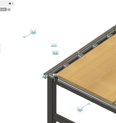

I've got an air cylinder that I made as an internal component and it has a sliding joint for the piston.  When I moved the air cylinder to a different part of the drawing, the joint symbol for the sliding joint remained out in space where I originally drew the component.  It's not to annoying right now but as this model gets more complex I think it's going to make a mess of keeping track of which joint symbols control which joints.  How do I get the joint symbol to stay with the component as I move it around?  Thank you for your help and here's a link to the drawing   https://a360.co/3xOkYcc

The joint symbols aren't in random places.  they are exactly where you put them.
in the circumstance of the component pictured below,  what you did was move the body with in it's component, not the component itself.  every thing else about the component stayed in place.

There are two things that I saw that are leading to this:
  1. As-Built Rigid Joint.  Because you are not picking any actual geometry for this kind of joint, the joint icon is placed at the component origin of (I think) the first component (in this case, it doesn't matter, because the origins are the same):
    so, for components whose body geometry is located away from their origin, this will cause the icon to be, also, located away from the geometry.
  2. For the Revolute joint, the icon is placed in the "correct" location at the time it is created:
    but, then, the next feature is a Body Move, which moves the body away from its home location.  If, instead, you used Component Move, the joint icon would move with the components
