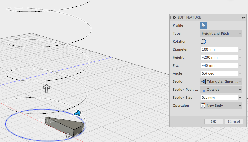

Actually, I'd like to design a spiral stair like this
but I think there are no helix/spiral and curve driven pattern at Fusion 360. (please check the video 6:07 / 7:14)
I tried making the helix/spiral by Create>coil.

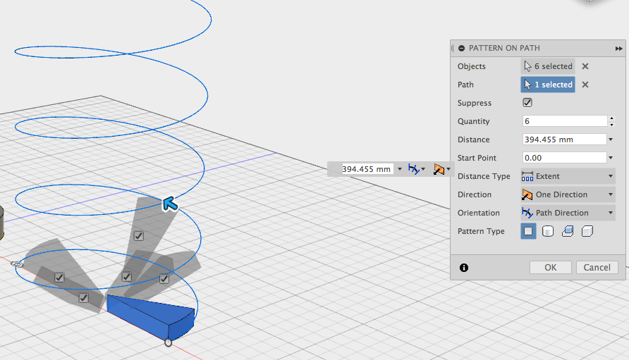

and Create>Pattern>Pattern on path
It didn't work well.
please tell me the way to design the stair.

No, unfortunately patterning along a path does not work in this case. Maybe the script posted later in this thread can help.
Thank you! It's a perfect answer for me.
