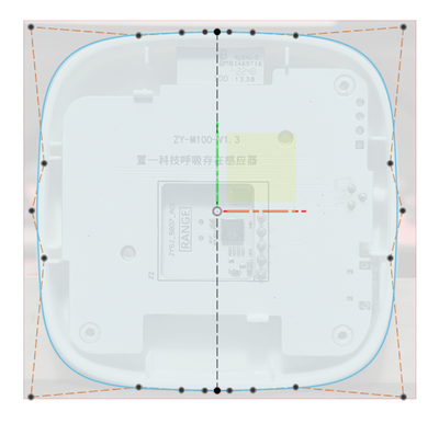

I'm trying to model a backplate for a smart home sensor. The issue I'm running into is that the outer edges have a long sweeping curve and I have no idea how to re-create it besides using a fit point spline and doing my best to follow the curve and then copying it to the other corners. That works, but I just feel like there's a better way. Using fillet is pretty close, but not quite there.

Use a control point spline.  Constrain and dimension the control points to keep all four quadrants equal:
Note: There are extra points showing at the top and bottom.  Use the side points.

As the shape looks to be mirror symmetric across the horizontal and vertical axis, only 1/4 of the outline has to be sketches using a single control point spline. I used a single-span 4-degree control point spline (5 control points) in the attached design with the proper constraints. That means that the construction lines that connect the control points are horizontal/vertical. As there is another symmetry across the red axis (dash dotted line) , there is an equal constraint on two of the construction lines (red circles). That recreates the shape well enough!
If more precision is desired I'd add another control point and re-apply constraints and adjust the control points as needed to better match the shape.

Using the control spline with constraints was it. I knew there was a proper way to do this without a thousand control points.
I'll keep the trace part in mind, but this plate has a bunch of fins on the back so I ended up with a super wavy line. Agreed that the photo isn't the most ideal (except manufacturer photos seem to be more solid). I can make sure I'm level, but not that it's parallel.
