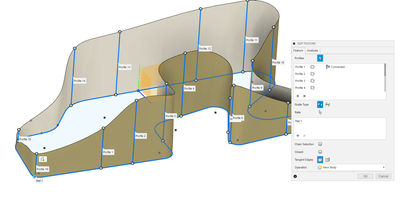

I'm trying to create a 3d print of this track with the proper elevations.  I've drawn the track on a single plane but really not sure how to go about "extruding" it from the plane to these different elevations.  I'm not sure extrude is the correct word here, looking for the method I should use. To even add more complexity to it, the turns have 6 or 10 degrees of banking and hte track width can vary.
I'm looking for direction / methodology on how this can be accomplished.
I've attached a pic of the track that shows the elevations, and my fusion file that only contains the basic sketch.

davebYYPCU
Two Lofts and a Thicken,
Demo had to remake sections of the layout for finicky loft errors, not smooth (coincident points and or tangency)
First loft constructs the undulation,
second one is track width and camber adjustments.
Night help....

My comment was there for a reason, your first sketch is / was not accurately constructed, first step to failed Loft. (Should be one loft)
My Demo had to remake sections of the layout for finicky loft errors, not smooth (coincident points and or tangency)
Absolutely, Loft is finicky.
Your original layout sketch was broken in many places, and I lost the fully constrained status when editing it.
All curves must connect to the end point of the line and be tangent constrained.  Don't have this condition, Rails will fail.  At the end of your first Loft, the end of curve and next straight line is / was not Tangent.  When I fixed that the 5th sketch, Sketch 18 broke.  To connect articles in a profile sketch you must Project > Intersect the Rail and connect to that dot.  You projected some other point, and the changed tangency broke the sketch.
Black dots on high left side gave me the most grief.  Still 3 missing tangent constraints red circles.
Please note, these two intersections are constructed differently (very close zoom).  Use Tangent Arc tool to create the top one, and 3 point arc the lower one, the non intersection can also be tangent.  Make both white end points coincident to each other, and they will not be shown as per top example, when correct Loft will work first time.

Now let's fix the file you attached and complete the loft.
First, let's finalize this sketch. Blacken all the lines.
Make all height sketches vertical. I don't know if this is important, but I will do it.
Connect the lofts little by little so that you can see where the errors are.
We were able to connect without error.
