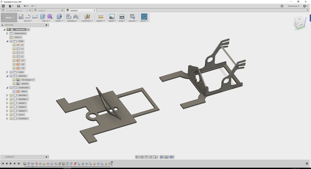

What's the best way to prepare something like this for laser cutting, in a single .dxf file?

You might be able to layout every thing using the script used in the video below. Link to youtube page.

That looks very very promising.  Thanks
