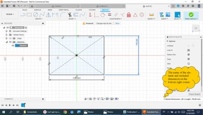

I'm new so maybe it's a simple user error. I'm drawing a center point rectangle on an empty sketch. When I press enter to commit the triangle the sketch doesn't show as fully constrained. I can't figure out what am i doing wrong. I tried resetting all setting to default but with no luck.
Attached is an example of a file I created by:
1) Create sketch by selecting xy plane
2) draw random center point rectangle. Clicking on the center and stretching it out.
Note the horizontal lines are blue and not black but I am able to extrude the shape into a box.
Thanks in advance

jhackney1972
You are missing one dimension to have a fully constrained sketch.
