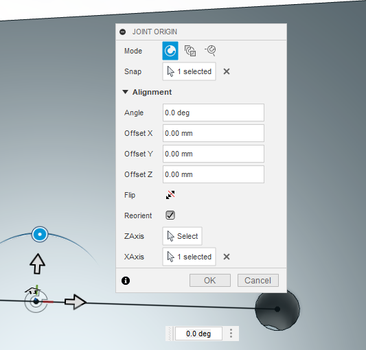

The attached file was created with an imported step file that does not align with Fusion 360's global XY plane - it is floating in outer space.
Question:
What is the best way to align the center of the two holes with Fusion 360's global XY plane? The center points of the two holes must align with the X axis.

@laughingcreek this issue resurfaced in a real-world application. Trying to use the component/joint method we discussed but must be missing a step. The holes are not aligning to the X axis.

Message 12 of 20
davebYYPCU
In your case, before making the Joint, adjust the Joint Origin disc, to align to the sketched line, click re-orientate, and rotate the required amount.
Frankly the Joint Origin is not required, as the Joint itself can select midpoint of the line, and the triad does the rotate.

componentscience
Hmm re-orientate is used before making the joint (0:45), aligning the X axis to the sketched line.

davebYYPCU
I finally found a way to fix that misalignment, but the reciprocal calculation, (-1.917 deg) did / would not register, and that is very likely why, you said the angle adjust was incrementing 5 deg.

etfrench
Here's another method.  Just requires adding another component at the point where the holes align with the X axis.
Convert the body to a component.
Use a revolute joint with the joint origin at one of the holes and the other at the main Origin.
Create a sketch.
Project the body to the sketch.
Draw a circle from the Origin to the other hole.
Draw a line from the Origin to the circle with a Horizontal/Vertical constraint.
Draw a circle at endpoint of the line.
Extrude the circle.
Create a revolute joint between the second hole and the extruded circle.

etfrench
The measure tool is only approximate and depends on the units setting in Preferences. Using a joint will always be more accurate.

etfrench
The first revolute joint aligns the model at the origin on one of the planes.  The second revolute joint aligns it perfectly on the axis.  Using the Measure tool to place items can result in cumulative errors in large assemblies as it rounds the number.
