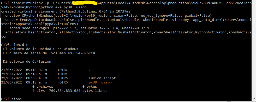

3. Back in the command prompt on step 1 (a single line, change in above path slashes by backslashes, and set <username> accordingly):
virtualenv -p  C:\Users\<username>\AppData\Local\Autodesk\webdeploy\production\59c8a288d74003935db5128cd3acb5349f9d794a\Python\python.exe py39_fusion
This will create a virtual python environment under the py39_fusion directory:

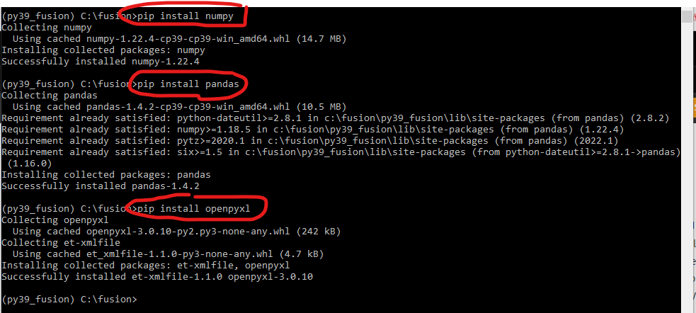

5. Install numpy and pandas modules, from command prompt:
pip install numpy
pip install pandas
pip install openpyxl
You can check the content of the py39_fusion\Lib\site-packages directory for the new modules installed:

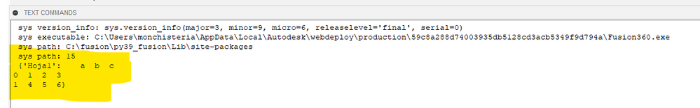

7. Finally run the script and check for the data in Text Commands window:
