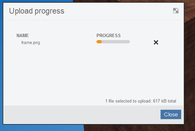

Hi all!
Is there any way to upload image file (e.g. in PNG file format) into active project via API?
Regasrds!
2016-06-02 18_54_49-Autodesk Fusion 360.png2016-06-02 18_54_03-Autodesk Fusion 360.png

Unfortunately data.activeProject API wasn't implemented yet. If you know which project you are going to upload your image file to, there would be a workaround for you.
The following codes would demo how to do that.
#Author-
#Description-
import adsk.core, adsk.fusion, adsk.cam, traceback
import time
def run(context):
    ui = None
    try:
        ui  = app.userInterface
        activeProject = None
        for project in app.data.dataProjects:
            if project.name == "Marshal's First Project":
                activeProject = project
                break
        uploadfuture = activeProject.rootFolder.uploadFile('/Users/tum/Desktop/My Picture.png')
        while uploadfuture.uploadState == adsk.core.UploadStates.UploadProcessing:
            time.sleep(1)
            adsk.doEvents()
        if uploadfuture.uploadState == adsk.core.UploadStates.UploadFinished:
            ui.messageBox('Upload succeeded {}'.format(activeProject.name))
        else:
            ui.messageBox('Upload failed.')
    except:
        if ui:
Marshal
Marshal Tu
Fusion Developer
MiWaNiZa
Thank you Marshal!
Works like a charm!
