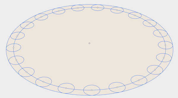

Hi guys,
so, if I have a sketch that looks like this
and want to have this by extruding all but the largest shape:
I have created the following code
Ptr<ObjectCollection> pinsExtrudeProfiles = ObjectCollection::create();
for (int j = 0; j < z2; j++) {
Ptr<Point3D> point = Point3D::create(r2*cos(2 * PI*j / z2), r2*sin(2 * PI*j / z2), 0);
Ptr<SketchCircle>circle = pHolderSketchCircles->addByCenterRadius(point, dc / 2);
// creating the outer rim Ptr<SketchCircle>cirle2 = pHolderSketchCircles->addByCenterRadius(Point3D::create(0, 0, 0), r2 + dc / 2); Ptr<SketchCircle>cirle3 = pHolderSketchCircles->addByCenterRadius(Point3D::create(0, 0, 0), r2 ); Ptr<Profiles> profiles = pHolderSketch->profiles(); /* There are four different types of profiles in this sketch now: The largest one is the center, star shaped The second largest is the thing between the pins The third largest is the outer part of the pin that was intersected by the second circle The fourth largest is the inner part of the pin that was intersected by the 2nd circle */ int areas[4] = {0,0,0,0}; for (int j = 0; j < profiles->count()-1; j++) { Ptr<Profile> profile = profiles->item(j); // rounding is important since the profile areas are pretty much all different // however, there are four clusters that we need to identify. int area = (int)(profile->areaProperties()->area() * 100000) ; bool skipped = false; for (int k = 0; k < 4; k++) { if (areas[k] == area) { skipped = true; break; // skip } } if (!skipped) { for (int k = 0; k < 4; k++) { if (areas[k] == 0) { areas[k] = area; break; } } } } // We need the first, second and third largest profile. Therefore we sort. std::sort(areas, areas + 4); for (int j = 0; j < profiles->count(); j++) { Ptr<Profile> profile = profiles->item(j); int area = (int)(profile->areaProperties()->area() * 100000); if (area == areas[0] || area == areas[1] || area == areas[2]) { pinsExtrudeProfiles->add(profile); } } Ptr<ExtrudeFeatureInput> pinsextrudeFeature = pinsextrudes->createInput(pinsExtrudeProfiles,
FeatureOperations::JoinFeatureOperation); pinsextrudeFeature->setDistanceExtent(false, ValueInput::createByReal(camthickness)); Ptr<ExtrudeFeature> pinsext = pinsextrudes->add(pinsextrudeFeature); adsk::doEvents();
Is this the best way of doing it? I have some multiple issues with this:
- the areas turn out to be not of equal size numerically, therefore I need to round them.
- first, finding out which different shape sizes are there, then sorting them before selecting everything else but the largest one seems awkward.
- calculation takes up quite some time. Is there a way to programmatically turn of history
 Is it too much to ask for a shape selection query language? I would certainly appreceate some sort of
Ptr<ObjectCollection> pinsExtrudeProfiles ="select
top(profiles->count()-1)
from pHolderSketch->profiles()
order by profile->areaProperties()->area() desc";
Thanks in advance,
rudisoft

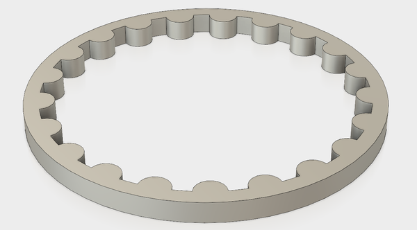

How about this?  Instead of looking at the shape, look at the topology of each profile.  All of the profiles, except for the big center one, are made up of 5 or less segments.  I did a quick test in Python and here's the code.
# Add all profiles that have 5 or less segments.
extProfiles = adsk.core.ObjectCollection.create()
prof = adsk.fusion.Profile.cast(None)
for prof in sk.profiles:
    # Get the single loop of the profile.
loop = prof.profileLoops.item(0) if loop.profileCurves.count <= 5: extProfiles.add(prof) rootComp.features.extrudeFeatures.addSimple(extProfiles, adsk.core.ValueInput.createByReal(dc), adsk.fusion.FeatureOperations.NewBodyFeatureOperation)

rudisoft
Thanks Brian,
I translated this to C++ and it works like a charm. So here it is for anybody who wants to grab.
Ptr<SketchCircle>cirle3 = pHolderSketchCircles->addByCenterRadius(Point3D::create(0, 0, 0), r2);
for (int k = 0; k < profiles->count(); k++) {
	Ptr<Profile> profile = profiles->item(k);
	Ptr<ProfileLoop> loop = profile->profileLoops()->item(0);
	if(loop->profileCurves()->count()<=5){
Ptr<ExtrudeFeatureInput> pinsextrudeFeature = pinsextrudes->createInput(pinsExtrudeProfiles, FeatureOperations::JoinFeatureOperation);
Ptr<BRepBody>pinsBody = pinsext->bodies()->item(0);
I'll certainly will look into profile loops a little closer in the future.
