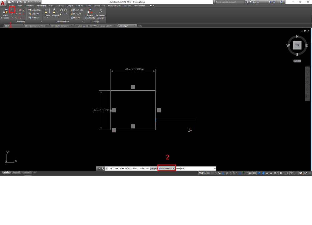

Try This :
- COINCIDENT
- Select AUTO CONSTRAIN from Commandline
- Select the Rectangle and Line (The Rectangle and endpoint of Line should be intersecting)
Did it work?

Did you move your line and coincide it with Rectangle before doing the COINCIDE Command? Because it works for me.
SALMANUL FARIS![]()

if you can't get the first method try this:
- Select COINCIDE
- Pick the ENDPOINT of the line
- Press Enter to choose Object
- Select Rectangle
Hope this gets the job done
SALMANUL FARIS![]()

Command Sequence Below
Command: _GcCoincident
Select first point or [Object/Autoconstrain] <Object>:
Select second point or [Object] <Object>:
Select object:
Reason
That is to change the command from Select second point to Select object
SALMANUL FARIS![]()
