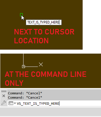

Floating Command Text Box:  I prefer only to have my commands being shown at the bottom at the Command Line
To change the location type:  DYNMODE        Set to:  -1    ( you must add the minus sign then 1 )
