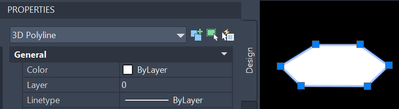

Hach in 3D polyline
Its possible to hach a 3D polyline?

@belotomindzo ,
Yes. When using HATCH, Select objects.

Great, but it would also be possible to do a 3D hatch, like hach this type of shapeCaptura de ecrã 2024-02-19 095845.png

@belotomindzo ,
Note what this link says:
"Enclosed areas can be hatched only if they are in a plane parallel to the XY plane of the current U...
You may want to explore other options like Materials.
