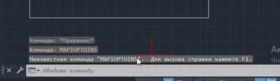

yury.starkov
en respuesta a: yury.starkov
imadHabash
Great .. You have to change the setting as mentioned in my previous message .
