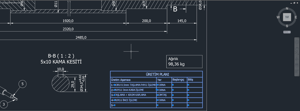

Text heights after burst an attribute
Hi everyone,
I have lots of inventor drawing(idw) and i want to collect em in an autocad file like project.
Before i copy into autocad file, i use burst command for title block and attributes but text got smaller than normal.
Yesterday everything was okay but today i have a problem with this. What did i wrong?
Here you can find relevant photos.
many thanks

Sorry ... i can not get your point from your attached images !? you may need to check your text style .

Look at the number in the table.. Yesterday i saved another drawing and used burst command there was no problem at all.
For better understanding i added dxf file here.
