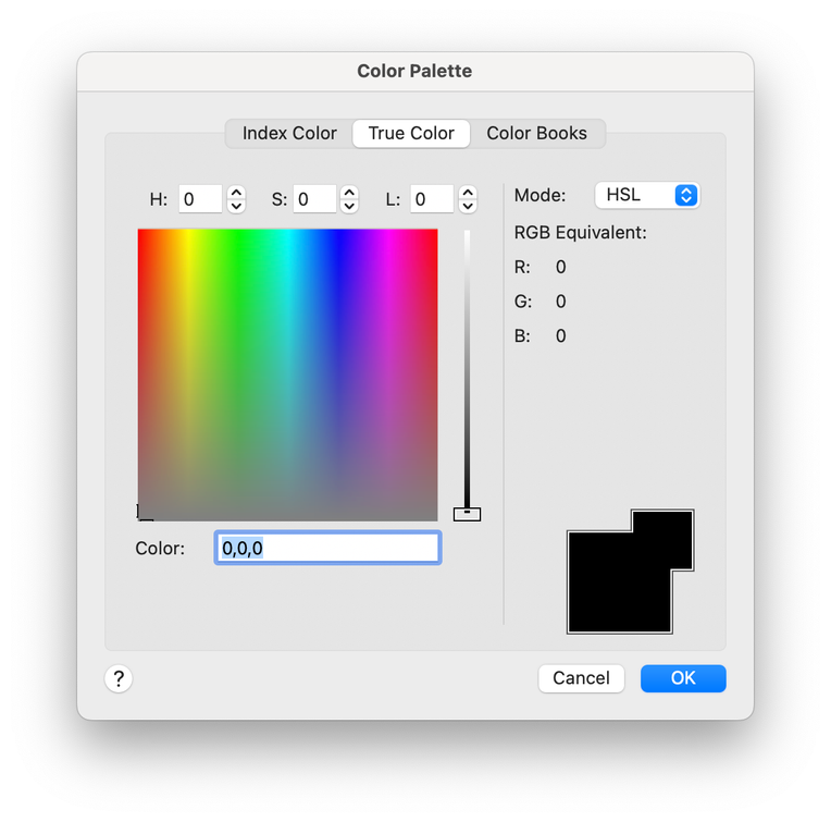

Looks like you use BMPOUT command to export drawing to BMP format.
You can use 2D Wireframe visual Style for exporting your drawing to BMP. In order to get rid of red lines you simply need to change color of the "L1D0" Layer from Red to "0,0,0" (HSL or RGB) True color:
See attached drawing where I changed color of this Layer.

This is helpful, thanks! Unfortunately this still results in undesirable seams between the fully saturated and gradient regions. Is there any way to smooth out that polyline between the white and gradient regions? Combining the hatches somehow? Otherwise, I can see if the results come out fine or try editing the image externally.

The region I'm worried about is the small black line between the white region and the gradient region on both sides, outlined in red here. I'm concerned that the machine will interpret that as the intended exposure at the location, resulting in a strangely formed photoresist structure.
Would I be able to make the polylines invisible or infinitely thin while exporting to bmp? It's the only format this application accepts, and I'm concerned about intermediate exports disrupting the scale of the drawing.

Hi @jtpausti ,
Yes, you can move these polylines to another Layer and turn it off before exporting to BMP or other raster format - JPG, PNG.
You can also use JPGOUT and PNGOUT commands.
If you are worried about drawing scale, you can use the trick with creating PDF at first (as I wrote before, and >>>>here<<<<) and then exporting PDF to raster format in Preview.app
