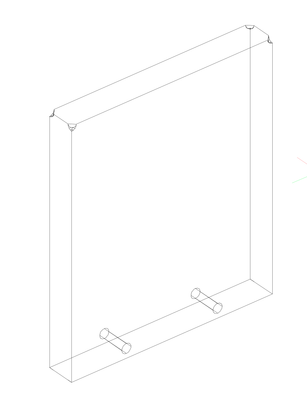

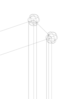

I think I figured it out, but I'm not sure if there is a simpler way. I took the bottom half of the sliced side and sliced all four vertical edges off of the model. Then I placed a 1/8" sphere at the top corner of each of the prisms I created and subtracted the spherical portion from the prism corner. I then used UNION on the prisms and joined them back to the main part. I have attached screen shots. If there is an easier way to do this, I would love to know. Thanks again for your help.
