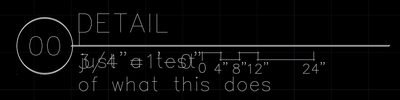

When I insert the Z block into a new drawing (Windows AutoCAD), this is what I am seeing when I enter some text in the first multi-line attribute.
I have not dissected your block to see if this is intentional. I see also that you have custom fonts (non-Windows or AutoCAD provided) that I don't have.  So some font substitution is taking place.
Is it possible to share your fonts for testing on my side? I want to make sure this looks correct before I enter the Mac side of this issue.
