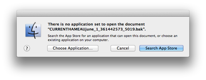

I can't imagine accidenatlly deleting a drawing however, when double click the bak file I get the following, and when, is there another application to open it, LT is not highlighted for opening.
Glenn

Of course you should get this. But as I wrote in my first response, you need to rename (change extension) of the bak file to dwg, than you will be able to open it in AutoCAD by double-clicking on it in Finder.

All done.. thanks
