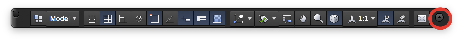

If I understand your question correctly: you have difficulties with changing 3d viewpoint in the drawing area.
If you are using full version of AutoCAD (not AutoCAD LT), than you can use 3DORBIT command to rotate view in 3D:
- Expand Status Bar with this button:
- Than use 3DORBIT button:
You can also use ViewCube - it is on the top right of the drawing area, or Shift+Scroll Wheel on mouse.
