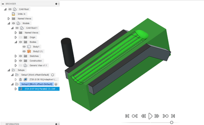

Hello Forum,
I have a bracket that I need to machine a radiused bottom shallow slot down one length. The part is machined otherwise. I have tried 2D contour and was not getting what I wanted. I need the tool path to go straight through the slot so as the slot is open at both ends of the blank I've made. I expect there is some setting or path selection I am getting wrong. Using .375 2 flute ball mill in 6061 Aluminum. Picture and file attached. Thanks. Jgaertner

You cannot use 2D toolpath to machine 3D feature, try Parallel or Scallop.

Hmmm, a little bit of confusion with body selection, here is clean version of it.

Thank you for your help. Is it not possible to select the existing model to have Fusion machine this slot? If I understand your sample, you created a new plane, drew a surface on that plane that is not part of the part and then selected that new surface as the contour/profile to be machined? Seems like one should be able to do this with the existing model? I do know you have to draw machining boundaries some times... Jgaertner

Yes, it is possible to use main model, I encountered some issues when attempting to drive tool past edges and fiddling with options did not please my fancy so I made offset of groove surface without adding any value to it.
I then extended edges past main model, constructed sketch and extrude it to cut off round side of new surface.
I then selected that surface as model in setup to get strait passes overlapping main model edges without tool path spilling over into goofy motions.

I sure wish one could program with Fusion without adding all these extra sketches. If I were doing this on a manual mill I could just machine past the stock and reverse paths with a new offset. I am trying to learn how to use Fusion
since its the tool I have"bought". But it seems to have some issue with doing very simple operations. But so does SolidWorks. Thanks again for your help. 3 hours to learn how to mill a radiused slot?   Jgaertner
