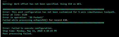

I am trying to machine a four start helix . I have tried so many different ways but always end up with the following warning: Dependency  on operation set up2 is ignored because it doesn't use axis substitution. Toolpaths are generated and simulation plays OK but so far I have had no success in getting any g-code when I attempt to Post Process

in reply to: Anonymous
Hi Vick,
              thanks for replying. the problem is that whenever I get a yellow warning flag and even though the screen shows tool paths and the simulation works it refuses to post process. All I get is Download failed.
In your setup, X and Y axis were pointing in negative direction, I reversed direction to be in sink with machine axis
orientation and file now posts fine with Haas PP.
Hi Vick,
               I tried with the axis in every different position possible but it still doesn't come up with g-code. I can't figure out what I am doing wrong.
In your setup, all axis need to point to positive direction, same as in machine. If you have problem posting, likely reason is wrong or badly configured post processor.
You don't need to try axis orientation in "every direction", only the correct one, then look for real problem somewhere else.
I see, the post shows 3 and 4 axis in description but produces error, some "post wizard" needs to look at that post.
DUH............ in post processor user parameters, you have to select rotary axis, assuming X, file posts without any issues.
Hi Vick,
             I'm beginning to feel inadequate, where do I find that screen. the only Post tabs I can find are in set up and also in actions in  Manufacture.
When you click on icon to post process file, window opens and you have to setup rotary axis for your machine the way I show in last post.
