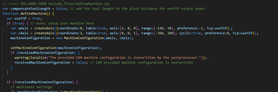

Your post is defining the machine configuration here:
change if (true) to if (false). This will allow you to use the machine file from Fusion and perform machine simulation
