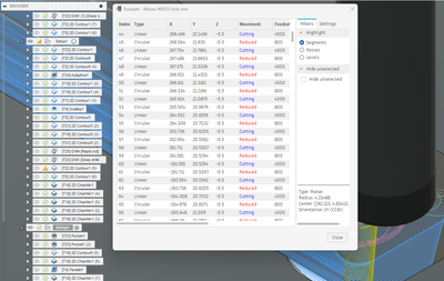

Hi guys,
I need help in reducing the feedrate while machining inner corners. There is a feature "Feed optimization" but can't get it to work.
Looking forward for your ideas.

Hi. I posted your code with a FANUC post processor and it appears to be working.

You may find that using Show Toolpath Data is helpful as you work though this issue.

Turning SMOOTHING ON solved this issue. The yellow lines in the internal corners indicates the feed optimization, which was missing without smoothing.
