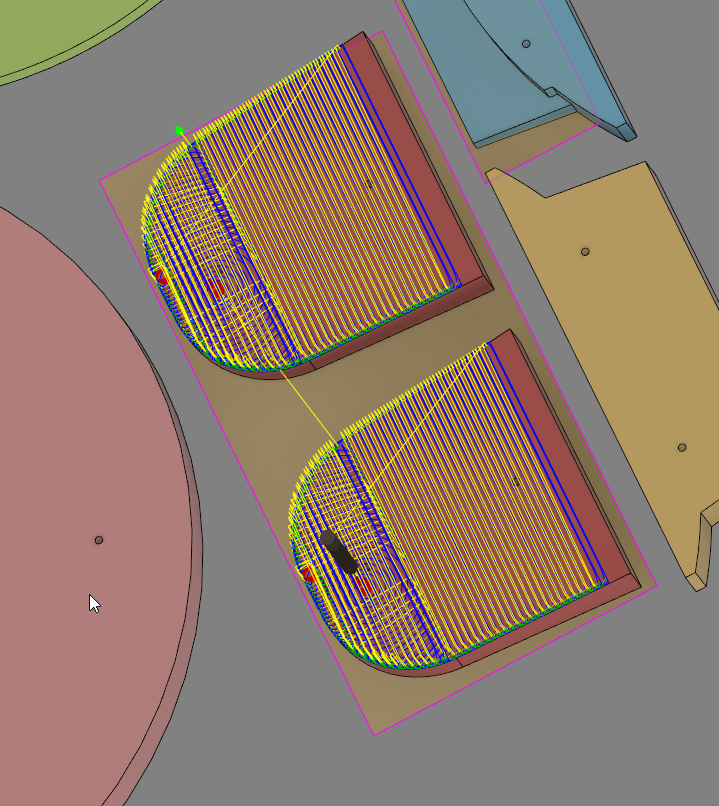

A few pointers for you, not sure adaptive is the best for this though. Basically you're making a pocket so you need to enable Machine Cavities.
First select the boundaries like this.
Then setup the passes tab like this.
Gives this toolpath.
