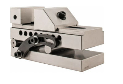

Is there a way to easily CNC this surface?  Parallel path seems like the best option but it will leave a little material in the corners.

Hi.  I'm assuming you want to do this in a 3-axis setup with the bottom of  your part parallel to the table.  Other than using a surfacing toolpath with a spherical tool, I can't think of a way to do this and generate your perfectly sharp corners.  But, you could set this up in a sine vise similar to this:
Another option would be to undercut the corners.  Then, you would have clearance for the radius of your ball mill.
