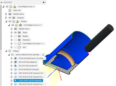

I unselected rest machining and got tool path, it's first roughing operation so rest machining is not in reference to anything.
You may wanna look at the chamfering operation, it's wiping out top third of the model.
Some functions are not within my license so I am not messing with rest of the file.
