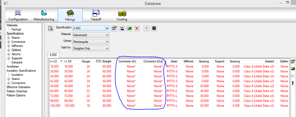

Some strange and unwelcome behavior - after seeing red color lock symbols on a fitting that was not using the known specification settings for connectors and querying the database the text in the relevant dialogs is also red color and the entries for the connectors are set to none with an asterisk and the list of available pressure classes in drop down has acquired multiple duplicates.

1) The RED text in the Specifications editor means that the specification entries were pointing to something that no longer exists in the database. Look at the connector In/Out settings fo the image you posted...they're not set. So whatever connector they WERE pointing to was deleted, renamed or moved to a different group.
2) The Red UnLocked icons in the ITM Editor indicates that those settings were carried over from the previously placed item.
