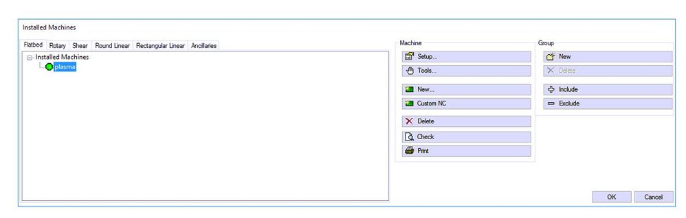

Hi. Suddenly the installed machine was missing and i had to make a new one.. Could there be a problem with updating to windows 10? Is there a way to find the old installed machine? Can't get my settings correct.. Version: 2016.0.0.F (25) Build: 3.04.988 SP2

I haven't got this problem before but it doesn't seem like upgrade OS might cause this problem. Can you post a screenshot of install machine tab ?

As you see I made a new installation witch, I called Plasma. I get the plasma to run, but I need to manually change a line in the program:
(JOBNAME)
(%5852)
N10 E500-E500
N12 M253 (Starke=0.60mm Typ: GALVANISERT)
When i write NC the N10 line is E0-E0. So i just have to change this to E500-E500.

About the NC code you might need to go to the Set up of Machine to check the Post Processor to find the right VLP file that you need to use to get the compatible code for your machine. About the nest I don't think it's related to the machine setting so you might need to decrease the margin just to enough for compensate your tool width which is about 2mm for normal plasma
