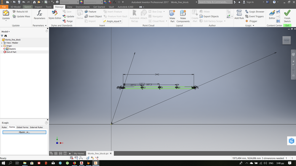

Hi my name is George and i am new with inventor.
i am trying to set parameters to a sketch in 2d which we use it in deffernts dimensions where i work.the problem is tha when i choose the smaller part where some holes should disapear i have this part
Through i logic a have make this holes "false" but istead it makes them "0 '' and this two dimension appears

This is the rule i use:

@Anonymous, it appears to me like you're trying to sketch your part like you would in AutoCAD, and have your iLogic control your sketch by turning the "holes" (sketched circles) on and off. Is that correct?
If so, you'll be much better off extruding your part into a 3D solid, and using the Hole and Pattern tools to make the holes. Then you can use the iLogic to suppress the Hole features.
iLogic can automate sketches but it's much more complicated, and isn't necessary in this case. Pretty much the only time you should need to use iLogic to control a sketch is when you're using iLogic to create a part from scratch, such as for a configurator.
90% of the time, you'll be using iLogic to control parameters (dimensions), and the suppression of 3D features. There's no need to suppress or create 2D sketch features like circles.

FYI, when you say
dim7a=False, you are telling Inventor to use the Boolean True\False. It sees that the value needs a numeric (double) so it automatically converts the Boolean to its bit (tiny integer) value 0,1, then stores the False equivalent (0) to your variable. Turning it to 0 does not remove it, as you can tell.
DRoam is right, there are easier methods from the 3D modeling environment. To address the 3D issue, you could model it in 3D and then project the modeled geometry back to a single 2D sketch (like a completed view/flat pattern) that you update and use for your CNC.
However, with iLogic (better to use VB.Net, with Visual Studio at this level) and a LOT more setup and coding, you can create a sketch with holes, then add attributes to the circles (via code), then save that sketch for reuse as a template, where you can find the circles that have your tagged attributes and delete them via code (or set construction).
Another method using all parameters is to create a pattern in a sketch. Component patterns (arrays) can take a single item (like your hole circle) and make it many (square or circlular). The neat part is the pattern's count is a parameter you can label, find and edit. The bad part is there must at least be 1 or it will not work. Also you could use the parameter of the pattern to chase the sketch objects back to the original circle and set its construction mode on/off as you need. If you dimensioned the first hole's position, you could chase that back to the circle too.

Thank you very much for the support..i finally set parameters to my sketch and it works perfect...i did as you proposed i 3d mode...now i am going to write the cam files for my cnc machine. i have one more question i am using this code
