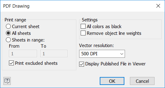

While exporting to PDF Through VBA (api), it is not possible to alter the option Print excluded sheets and Display Published File in Viewer. (see screenshot):Export -> PDF -> options
What I tried so far without success:
- Searching for the options here on the forum: only 6 options found.
- Using the Translator.HasSaveCopyAsOptions to get the default options:
I've found 43 options, including the previous 6 and an options Launch_Viewer - Launch_Viewer = False didn't work
- I've tried ViewPDFWhenFinished = False (option found for 3D PDF)
Any help or suggestion in the right direction would be welcome.

I'll agree I can't find that option. Can you try this...
Dim Doc As DrawingDocument = ThisApplication.ActiveDocument Dim MyArrayList As New ArrayList For Each oSheet As Sheet In Doc.Sheets If oSheet.ExcludeFromPrinting Then MyArrayList.Add(oSheet.Name) oSheet.ExcludeFromPrinting = False End If Next
'your code to export pdf here
For Each oSheet As Sheet In Doc.Sheets If MyArrayList.Contains(oSheet.Name) Then oSheet.ExcludeFromPrinting = True Next

Engineering team knows about Launch_Viewer option which is not working for PDF translator. A change request is already created with engineering team and details are given below.
INVGEN - 2958 - API: The Launch_Viewer option for PDF translator does not work (Display Published File in Viewer)
As a workaround, you can try suggestion in below forum discussion link.
