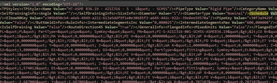

I have to duplicate many pipe styles in routed system, for example from schedule 10s to 5s,
I tried to export all in xml and changing 10S with 5S but I have this error:
"The wall thickness of the pipe component does not match the wall thickness value specified in the style."
Any idea?

I would not take this approach. Modifying the style is difficult but if you can get it to work it might be quicker. I would suggest to only do this in the editor. Note that only the pipe style follows the SCH set in the drop down. All the fittings inside the style do not automatically change.
There is no API support for this work so this is all manual changes unfortunately.
