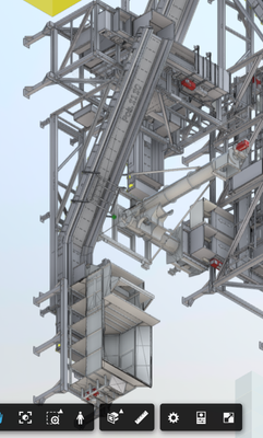

can someone help me with writing an iLogic program that can export one .RVT document with all parts and subassembly of an assembly. Because if I export .RVT file with Inventor export wizard I get a file in witch I can reach only one level lower that the whole assembly is. I am attaching a photo of assembly exported into Revit file with just one level of subassembly.
On that photo we can see the problem I have presented. Model marked with blue color have in Inventor also subassemblies and individual components, which in this case are exported as one.

Hi @DVNK4SZN , welcome to the forum.
Here is an iLogic version based off of the VBA example included in Inventor's API help files.
Hope that helps, Curtis

To the original question the only options are the same we have via the interface within Inventor.
