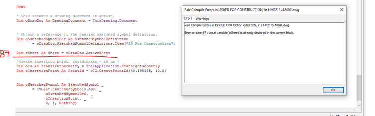

Thank you Tony,
I did try and getting this:
Tony_Yates
in reply to: Anonymous
Hi Paul,
Sorry I just added two rules together.
Try This:
