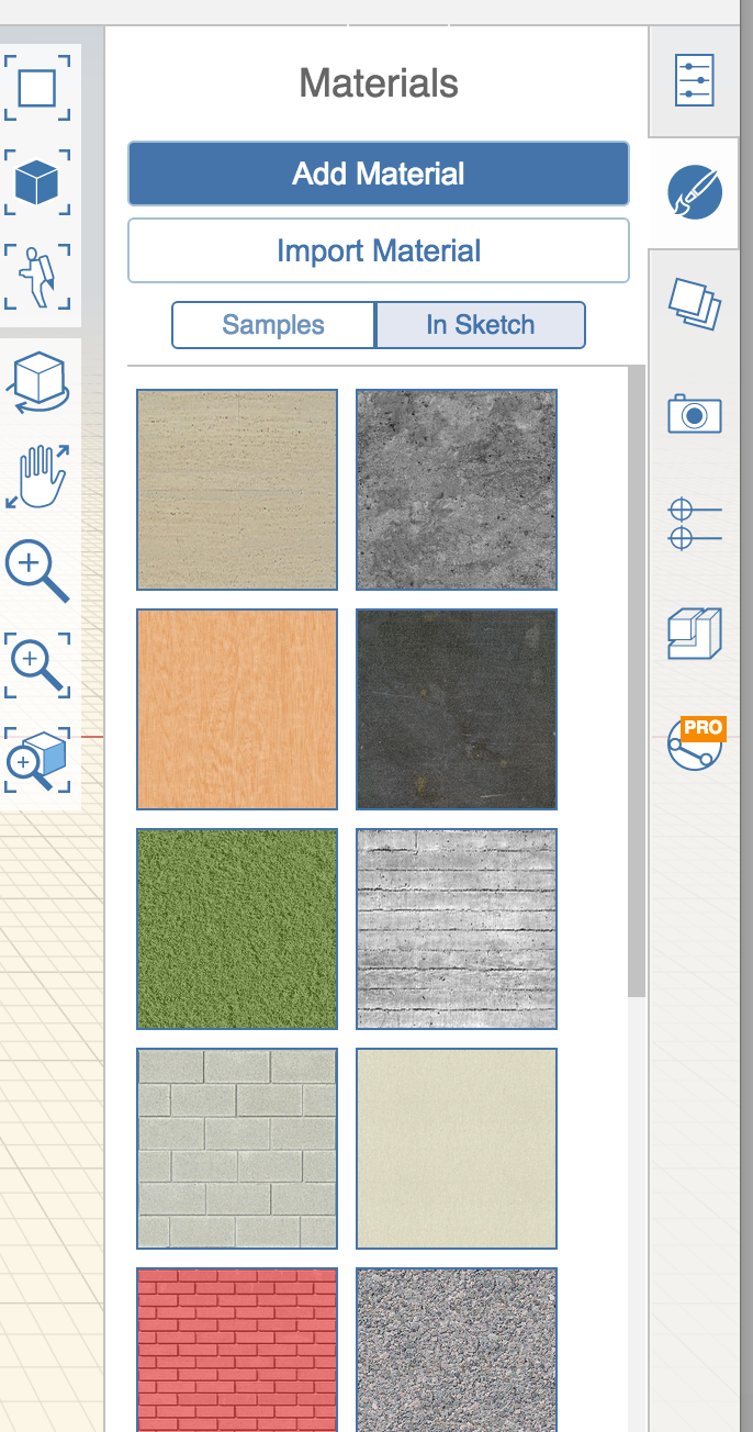

I'm trying to add a facade image to the face of my model, but can't figure out how to place it (as you do in Sketchup). I could cut it up in another program, according to each facet of the facade, but this seems like an unnecessary, additional step...Screen Capture.png

To add facade textures, you need to create a material. Click the Material tab on the right hand palette then Add Material. You can use the vertical and horiztontal dimensions to scale the bitmap to the face. We do net yet have an in-canvas editor for that.
