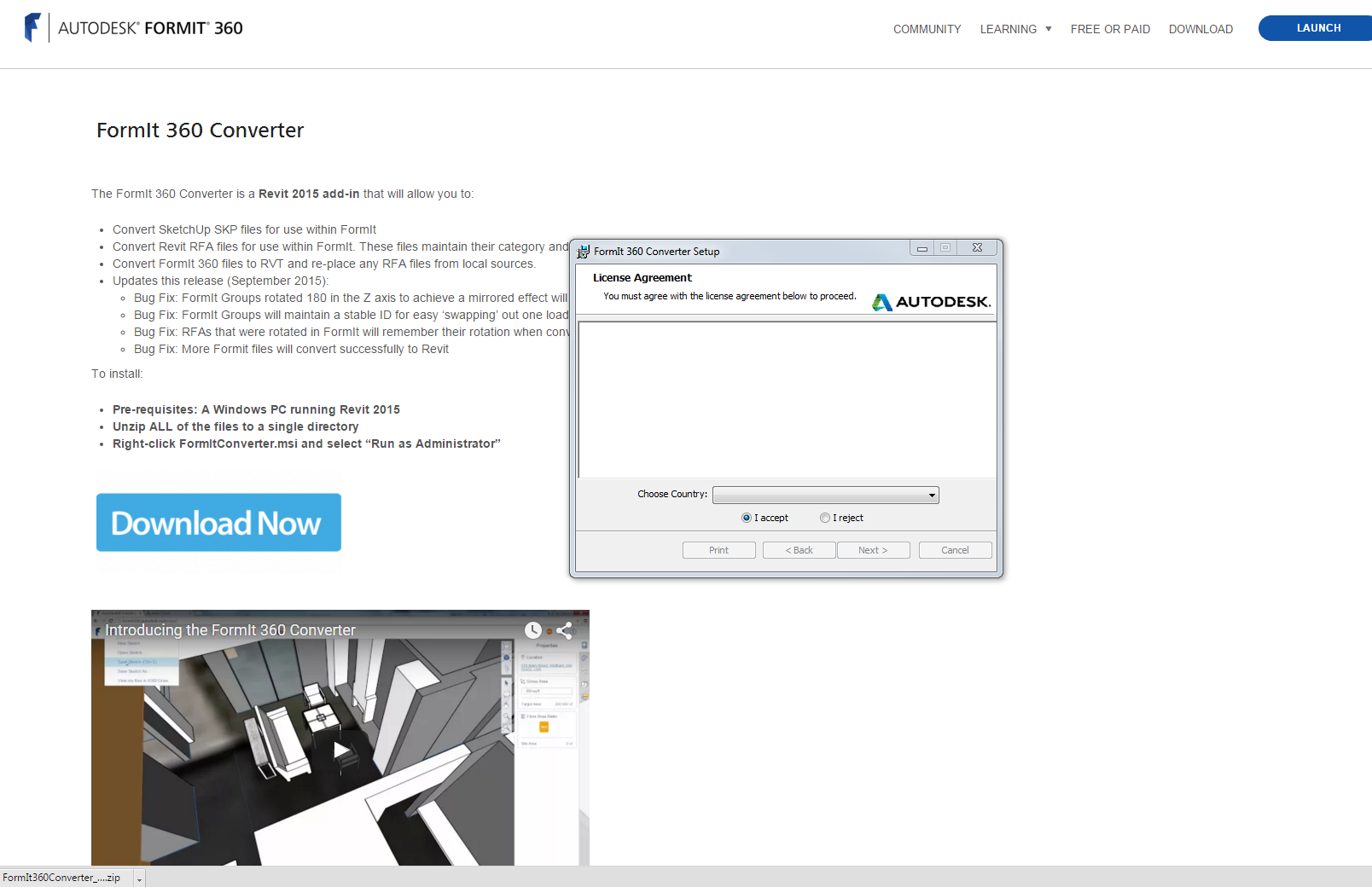

having issues downloading FormIt 360Converter

Thanks for downloading! Glad you were able to find us.
Your issue is a common one - you need to copy the ENTIRE contents of the zipped download. Then paste them into a folder (on your desktop is fine). Then run the installer!
We see the screenshot you posted when you're running the .msi file from inside the zip folder.
