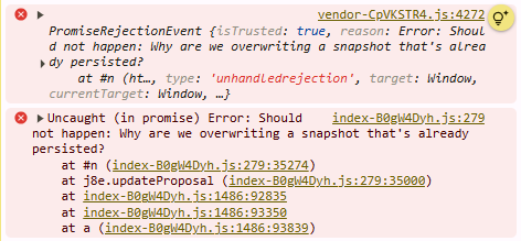

Hey all,
After your last update I have started getting weird issues with proposal rename. We duplicate an existing proposal and then we try to update it with the new name. The problem is that I am getting "unexpected error" and information that "Proposal with the given name already exists." I run update only once (that's what I see in console logging). What I see in Forma is that after the first rename the old name is coming back for a short while and then the API automatically is trying to update the name once again. Sometimes it happens a few times. Eventually it's getting updated but users can see many errors on Forma side. This is what I see in console.
Please let me know is this something that you can fix or maybe I am doing something wrong on my side. For proposal update I use the code that I've got from your team so I think that part should be correct. Thank you for your help.

evgenii_dobrovidov
Hi Miroslav!
This was indeed a regression on our end. We believe we fixed it, so please try again and let us know if the issue persists.
Sorry for the inconvenience and that it took so long to reply!
Kind regards,
Evgenii Dobrovidov
mjovic
Thank you Evgenii.
This works now.
