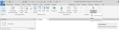

Hi, thanks for the feedback!
The Forma addin will appear in the Massing and Site tab (the old Spacemaker addin appears in its own Spacemaker tab).
https://help.autodeskforma.com/en/articles/6984724-revit-interoperability

Thanks Zach!
I suspected it would not be the same Spacemaker plugin, I just didn't know where to look.
