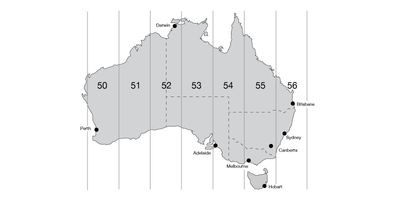

We have started using FORMA to get our projects off to a start, however the coordinate systems seem to be a bit unpredictable and you can only see this by exporting the OBJ file which comes with a Readme.txt file that contains the reference to the CRS (Coordinate Reference System).
Working in Australia there are a  number of grid systems across the continent called MGA (Map Grid Australia) and for some time FORMA has exported and loaded into Revit using, for example, MGA56 (EPSG:7856) for East Coast (Sydney and Brisbane). However a couple of times recently on a couple of projects it has just switched to WGS84/UTM Zone 56s which isn't the same thing.
The result is that rather than the coordinates being alignable, the same numbers appear to be circa 8.219km East and 0.387km North of where we are expecting it to be which then only leaves manual alignment as an option.
What would be ideal if you have plans to resolve this would be the ability to select from valid CRS's that apply to the area in question allowing the user to select. Not wanting to over complicate this but in Australia a recent update was issued to teh GDA Standard too so each MGA Zone has the old GDA94 standard and the new GDA2020 standard which each have their own EPSG codes the delta between these ranges across the coutry from circa 1.5m to 1.8m due to teh fact australia is drifting and we often have to align with data from the old GDA standard too.
I believe that the maths to translate between these CRS's is well established and available in code libraries, however it is hard for us as end users to implement this at our end, so it makes sense that this is built in at the point where the data is exported.
It would be amazing if this could be a feature, because when it works, it is amazing, but when it doesn't it presents us with a lot of really useful information that we can't use without risk!

Forma uses UTM zones as the basis for the internal coordinate system for projects. Which UTM zone this will be, will be chosen based on which zone that will enclose the project's location on the globe.
Then, the coordinate values Forma uses internally are relative to some reference point within - or very close to - the site. The reference point is specified in coordinates using that same UTM zone.
All exports produce data in the internal coordinate system. So, the coordinates you will get in an export are in the project's UTM zone, but relative to (offset from) the reference point. The Readme.txt file describes which UTM zone this is, and the location of the reference point. So - by taking the exported coordinate values, and adding the offset values in the Readme.txt, you will get the true coordinates for the geometries, in the specified UTM zone.
I think what has happened here, like you already mention, is that the national grid and one of the UTM zones are 1:1 compatible in some cases (inside a limited region). So things work inside that region, but outside, the differences will suddenly become large as the coordinate systems are no longer compatible. And this is what causes the unexpected offsets.
The export mechanism for Forma has not changed for a long time. I would recommend assuming the coordinate values are in the UTM zone, and with the coordinate value offsets, as specified in the Readme file.
