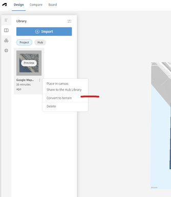

Hello Forma Team,
I have encountered an issue where I cannot create  a terrain from a created Library item
although in my extension the texture gets created correctly, when a library image item is created i get an error about the "bounding box being infinity large"
any idea what might be the issue?

Yes , I use the Forma Sdk to upload a blod then the createElementV2 to create the element and the
createItem to create the Library item(image) which I try to convert
here is  the code to get an idea

Hi @iklimis
This can be related to the image corners and the boundary box not being correctly defined or not being in the same coordinate system.
Could you please verify the following:
  1. Ensure that the image corners are correctly defined and within the expected bounds.
  2. Check that the boundary box for the image is correctly set and matches the coordinate system required by your application.
If both of these aspects are properly configured and the issue persists, please share any additional details or code snippets related to the boundary box that might help in diagnosing the problem further.
