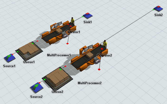

Hello, I already follow the step statistic collector but unable to get the same result. I have a problem with columns 3 and 4. I not sure what is the problem since I follow the same step. It is due to the version. I want to see for the operator 2.
Syn 1 Exact Length.fsm
