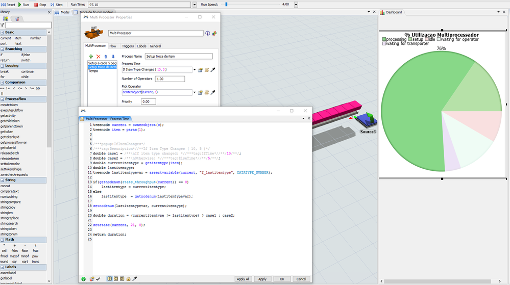

multiprocessor-setup-numero-pecas-setup-por-item.fsmA customer in Brazil requested to implement the pick list "If Itemtype Changes" (the same that we have in the Processor - Setup time field), inside the object Multiprocessor, specifically in the field 'Process Time'. As you can see in the image attached, we can solve such issue copying the code of the picklist "If item itemtype changed" from one processor to the multiprocessor and also setstate in code field to get setup state into dashboard

It sounds good. But I wonder why you emphasize "If Itemtype Changes" should be add to Combiner rather than Multiprocessor in title. Maybe it's a clerical errors cause your attach model use Multiprocessor.
BTW, expect for Multiprocessor, Other "Superclass Processor" object can decide setup time in specified trigger. I am not sure it's necessary for being a default pick list in other Processor, while it seems helpful in Multiprocessor.

Sorry, the right is add the pick list "If Itemtype Changes" in Multiprocessor and not Combiner.
