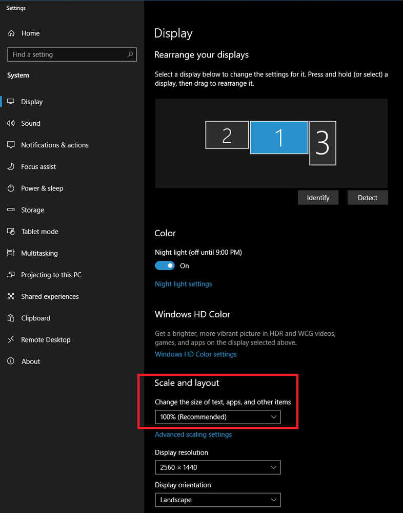

Could you tell us more about your Windows "Display settings"? Right-click the Windows desktop and select "Display settings" to open the window. Please post a screenshot showing the monitors and their positions. Also let us know which monitor is the main monitor and what the "Scale and layout" size percentages are for each monitor.
For example, here is a screenshot showing this information on a coworker's computer, monitor 2 is the main monitor, and both monitors are at 100% size scaling:

Thanks. Could you give us the display settings for your second monitor too?
In order to run the video recorder you need to change the monitor's scaling to 100%. You can do this on that Display settings window you sent a picture of. After you change the monitor scaling to 100% do you still see the issue with the jumping property window?

We cannot replicate the issue on any of our computers. Matthew's question about whether the issue goes away when you set the scaling to 100% was not a suggestion for a solution. It was a request for information to help us debug what is happening so that we can replicate the issue and fix it.
After you change the monitor scaling to 100% do you still see the issue with the jumping property window or not?
Your graphics driver is version 441.66 from December 2019. The latest driver from Nvidia is 451.67 from 9 July 2020. The latest Surface Book 2 drivers from Microsoft are from 10 July 2020.
https://www.microsoft.com/en-us/download/details.aspx?id=56261
To determine whether the driver is the issue, try updating to the latest drivers from Microsoft and let us know whether that helps.
