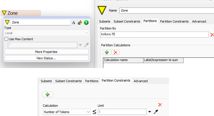

The tasks of the different tokens are getting mixed up (travel task of next token starts before unload of current one). If you set the zone up to only allow one token per TE, this should be fixed.
