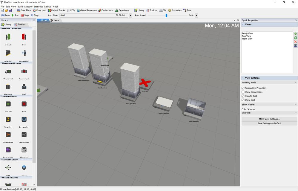

See attached picture.
Flexsim doesn't do that but HC does that.
My screen resolution is 3000x2000 and scaling is at 200%.
Any remedy?

FlexSimHC is currently running on the 7.5 FlexSim Engine, which was before FlexSim was updated to be high DPI aware. You can set your scaling to 100% which will make everything the same size relatively, but everything will also be smaller.

Would it make a difference if I installed HC 5.3 ?
Message 4 of 8
Matthew_Gillespie
No, 5.3 is also on the 7.5 engine

So there is nothing other than scaling to fix that?
I don't understand. HC didn't do that last spring.
Message 6 of 8
Matthew_Gillespie
This has been an issue since version 5.0 came out. I've had the scaling on my laptop monitor set to 100% since then.

Hello Matthew, a user reported to us the same issue with HC 5.3.2. Is there any plan to fix it in a future HC release or should we wait the full migration with the people module inside FlexSim ?
Message 8 of 8
Matthew_Gillespie
There are currently no plans to fix this in FlexSim HC.
