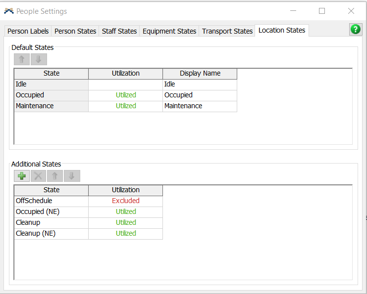

For instance, I have this in the tree view (4 state profiles per operating room):
This in people settings:
I use code similar to this to change my OR's states during simulation:

  • Could you please indicate what are the good practices to follow while working with states and state profile?
  • What is the difference between "people settings" and "state Tables"?
  • To what state profile are the people settings linked to?
  • What is the best way to add a state profile?
  • What is the best way to add a state?

Matthew_Gillespie
The People state dashboards look at the HC States state profile. The People Settings object is also tied to the HC States state profile and lets you configure whether each custom state counts as a Utilized state for Utilization calculations. So you usually just want to add custom states in the People Settings and then set the state of an object's HC States state profile.
Object obj = Model.find("OR1");
obj.stats.state("HC States").value = "Waiting for Anest";
You can add other state profiles to objects if you want, but then you need to manage that all yourself and you'd probably need to make your own stats collectors to make any state dashboards using those profiles.

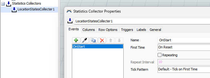

If you make a Average State chart for Location States that dashboard is displaying data from the HC States profile of the location objects in the model. The way it does this is with a Statistics Collector object that grabs the states of each individual object and puts them together into a table. Then a Calculated Table object takes that table and creates a new table of data with calculated percentages. The chart then uses that calculated table as the data to display.
If you double click on the LocationStates table in the People Statistics Tables section of the Toolbox and then click the Copy internal Statistics Collector button, it will add a copy of the statistics collector it uses to your toolbox.
You can open that up to see how it gets the data from the location's HC State profile.
To see the Calculated Table, select a Location States chart in a dashboard and in the Advanced panel click the Install button
This will add a new Calculated Table to your toolbox that will show you how the data is transformed from that gathered in the Statistics Collector into nice percentages.
If you have more questions about how to make your own charts from your own state profiles, please start a new question.
